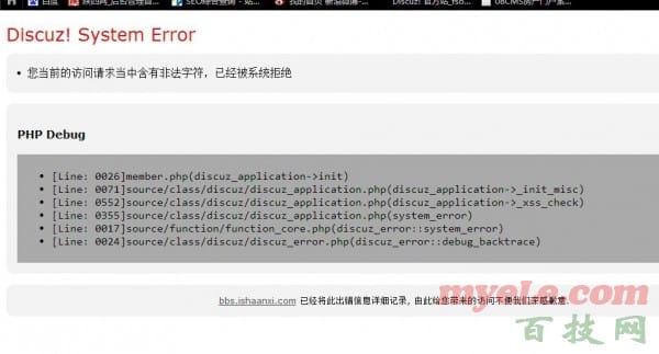

故障描述退出登录时出现”您当前的访问请求当中含有非法字符,已经被系统拒绝“错误。
解决方案:\source\class\discuz的discuz_application.php 查找
  1.     private function _xss_check() {
  2.                     static $check = array('"', '>', '<', '\'', '(', ')', 'CONTENT-TRANSFER-ENCODING');
  3.                     if(isset($_GET['formhash']) && $_GET['formhash'] !== formhash()) {
  4.                             system_error('request_tainting');
  5.                     }
  6.                     if($_SERVER['REQUEST_METHOD'] == 'GET' ) {
  7.                             $temp = $_SERVER['REQUEST_URI'];
  8.                     } elseif(empty ($_GET['formhash'])) {
  9.                             $temp = $_SERVER['REQUEST_URI'].file_get_contents('php://input');
  10.                     } else {
  11.                             $temp = '';
  12.                     }
  13.                     if(!empty($temp)) {
  14.                             $temp = strtoupper(urldecode(urldecode($temp)));
  15.                             foreach ($check as $str) {
  16.                                     if(strpos($temp, $str) !== false) {
  17.                                             system_error('request_tainting');
  18.                                     }
  19.                             }
  20.                     }
  21.                     return true;
  22.             }
复制代码
替换为:
  2.                     $temp = strtoupper(urldecode(urldecode($_SERVER['REQUEST_URI'])));
  3.                     if(strpos($temp, '<') !== false || strpos($temp, '"') !== false || strpos($temp, 'CONTENT-TRANSFER-ENCODING') !== false) {
  5.                     }
  6.                     return true;
  7.             }
复制代码
或使用官方方法解决:http://www.discuz.net/thread-3485502-1-1.html
上传覆盖同名文件,后台更新缓存,重新登录退出看看是否解决了。
